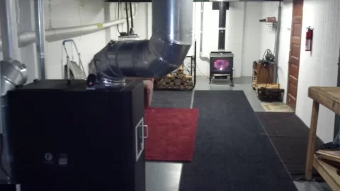

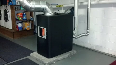

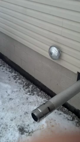

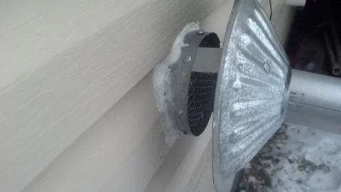

Here are a few pics to give an idea on how easy it can be (and cheap)!!
[Hearth.com] Harmen Accentra Insert with or without OAK [Hearth.com] Harmen Accentra Insert with or without OAK [Hearth.com] Harmen Accentra Insert with or without OAK [Hearth.com] Harmen Accentra Insert with or without OAK
