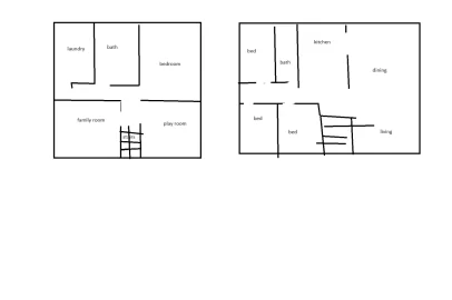

Hi, I have a rough sketch of my SPLIT ENTRY.It's a rough idea and like I said, when you come up my stairs, it's just bannisters, and open. WHen you go downstairs, there is a wall by the family room but it has a peak through hole and the doorway.
Like I said, I have about 1300 sq feet on each level.
The actual family room is 23 x 12 wide

A 61 would do ok and probably heat the downstairs and your kitchen, dining, and living room.

I think a 61 or 68 will do the OP just fine. The back bedrooms might need a little help with sub-zero temps.

You don't Think the 61 would make the room way too warm and unbearable
I think the heat will disperse nicely up the stairs. I'm heating a 2000 sq ft colonial with my stove in the living room, corner install pointing towards the stairs. Stove is set at 72. The downstairs stays at 72-73 and upstairs is 70-71.
The heat should rise up and push the cold air back to the stove.
