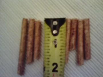

I'll try to post a pellet pic in a minute....
Even my advance chewed these pellets down

Brand of pellets= BIOPLUS INC WOOD FUEL PELLETS
