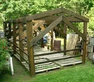

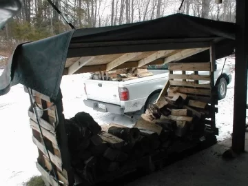

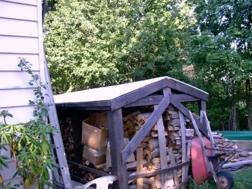

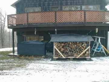

Here is one I used to use before I decided to just load it on the patio.

That's sweet Hog! I was thinking of going kind of crazy with it and forming them up and filling the walls with concrete so as to make a pretty permanent structure. I get weird ideas sometimes but I don't see myself selling this house anytime soon either....
Mine was built from all materials I had on hand.
I also built it to be temporary. The roof framing one part, each side with upright separate parts, all connected together with 2x4s & drywall screws.
Each fall I would get it out of the barn and set it up, and each spring I would take it apart and store it back in the barn.
Not sure how the concrete would work out but seems a tad overkill and permanent, but if that is the way you want to go, why not.
Since I have the concrete pad for the patio under that deck, I decided to put a good tarp on the deck and stack the wood on the patio. Usually about 3 cord worth, and about late November when things are starting to get colder. Before that I just stack a pallet worth on the patio and burn as needed. Come spring, its back to a patio with chairs etc.
Good luck with whatever you decide, the cost can't be beat!

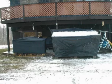

My shed was built almost exclusively from recycled pallets.
The "floor" is made from standard shipping pallets, the rest was made from
shipping material, (probably used for sheet metal of something similar) stained dark brown.
Originally it had a tarp for the roof, but that didn't last long. I used some sheets of plywood
that came from some skids from China, for the roof decking, and covered it with roll roofing.
Hold about 4-5 cords.

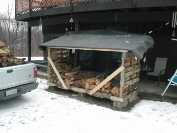

Here is one built by a fellow I know. Being painted made it look much nicer than it would have without it. It has worked out well for him.

Great ideas guys. I probably won't mess with the concrete now that I think about it until I decide I want it to be really permanent. I just bought this house (first one, yay!) last may so I'm not going anywhere soon.
It's good to get a visual on these structures so I can formulate a plan to build mine.
Thanks a bunch, ideas from this crew are always much appreciated.
