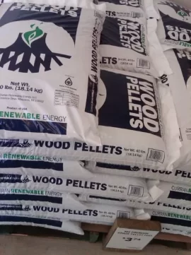

I just picked up a couple of bags at Lowes for $3.74 a bag ($187/ton). Things are getting scarce here on Long Island, with the Big Box stores switching over to summer items. If these burn OK for me I think I'll grab a ton.

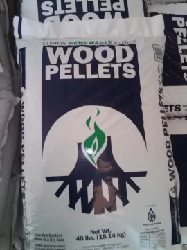

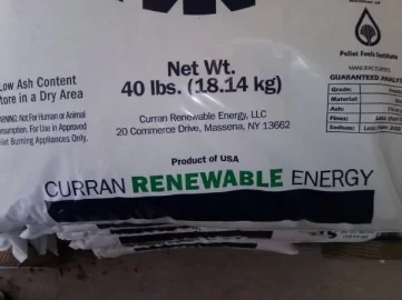

Curran's WOOD PELLETS in white bag w/ blue and green lettering were awful for me...bascially unburnable.
However, NORTH AMERICAN PELLETS in a clear bag are made by them and I'm VERY happy with this hardwood/softwood blend, especially at $3.74 per bag.
Hello
Our Lowe's just got some and they seem to be the mixture or blend of hard and soft woods.

The blue bag pellets were not so great. According to Curran Lowes/Home Depot stuff may have been dumped on a broker and ended up in a big box store. I'm selling the Curran Softwoods here. Clear bags Much better than the blue bag stuff. I've let two customers that use Cubex try the New Currans, trying to get a handle on which is better. One who burns in a Enerzone Bio-45 says the Currans have less ash than the cubex but also less heat. Another guy uses a Europa and says the Currans made more heat and more ash. So much for that. The Menielly buys should drop off a few bags of cubex here, I'll swap em with some Currans.
$260 a ton is our price picked up for the Curran Softwoods. I'd knock a little off for any Hearth.com member that wanted to try a few bags. Maybe $4.75 a bag or something.
