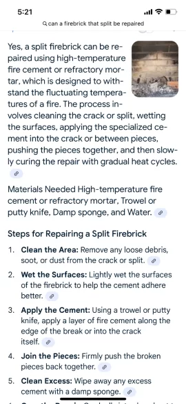

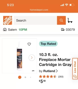

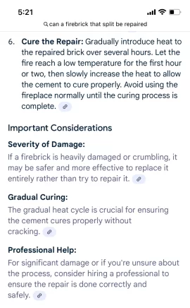

Has anyone repaired a cracked firebrick with refractory cement?
Don2222
Feb 1, 2010
9,335
Salem NH
Hello
I see it can be done but has anyone done this?
Is any refractory cement or refractory mortar adaquate?

Yes but it doesn't work very well
wood stove
It just doesn't hold up well at all. What stove is this for?
I've had excellent luck with it...but I wasn't trying to glue a pile of gravel back into a brick though either...
