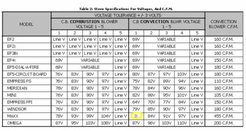

So I am just wondering if anyone with this same stove could tell me if it is normal for the convection fan to not be running in the #1 position?

Yes, They list "0" voltage output for the convection blower on heat range 1. With the massive heat exchanger it will radiate enough heat to keep the stove cool enough. I'll dig up the tech list if you need me too?

Here is the list I mentioned.
