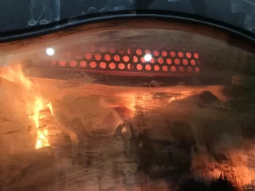

That pic is indeed what I mean, granted, sometimes how the wood is arranged or how the coals were when loaded I do not always see secondaries, by that I mean ghost flames.
