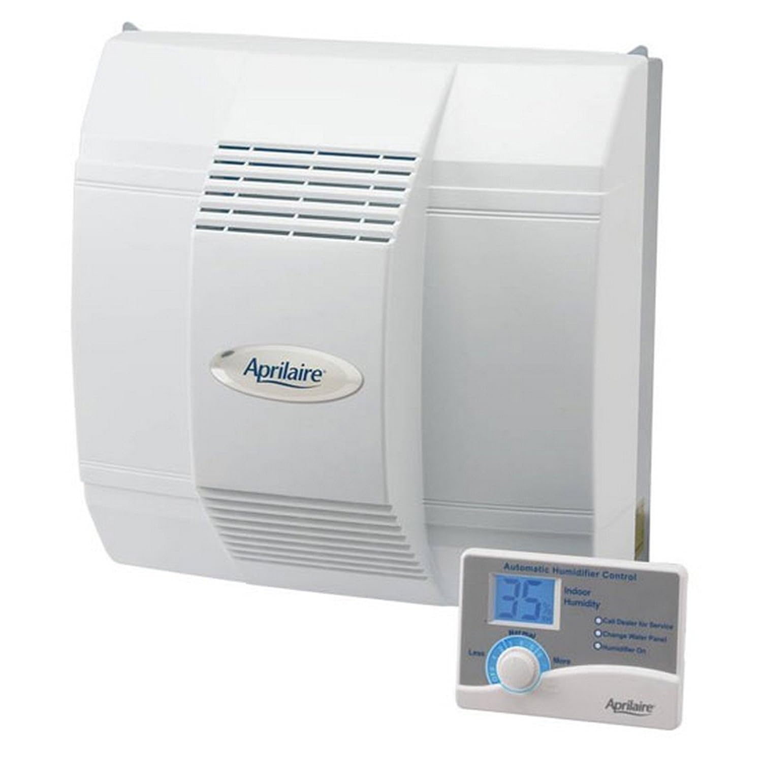

Get one of these and be done with the problem. Installs into you existing ductwork.
