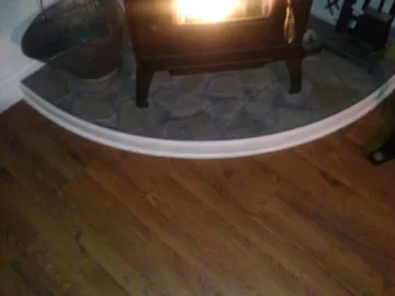

I put down a piece of plywood cut to shape. Then bent trim and quarter round glued to the front of plywood. Then played down a thick bed of mortar and ploped all the rocks I found down. Then grouted the next day. 10 years old and still looks good and its way thicker than the ones they sell. [Hearth.com] Hearth pad rules for Canada

I put down a piece of plywood cut to shape. Then bent trim and quarter round glued to the front of plywood. Then played down a thick bed of mortar and ploped all the rocks I found down. Then grouted the next day. 10 years old and still looks good and its way thicker than the ones they sell.View attachment 127070
Very nicely done!
Thanks Chuck. It was a easy fun project. And it was just a little area, not like grouting a giant floor. So the mess wasn't that bad either.
Bet you've visited Frank Lloyd Wright's house in Buffalo;lol Not sure if that particular house applies (never visited before I left the area:() but most of his relied heavily on indigenous materials for building ... your "found" rocks!
Like the curved trim and quarter round...
