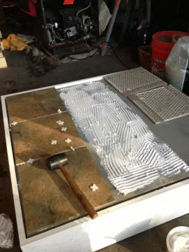

Simple 2x6 hearth with PVC board for trim around 3/4" plywood topped with cement board and porcelin tiles.
Remember to Back Butter those tiles for a good sticken!
Boy, I just found this! I never new I needed a Back Butter Buddy!
(broken link removed to https://www.flooringsupplyshop.com/back-butter-buddy-2181.html)

I would avoid the wood even if it`s pressure treated if it`s going to be getting wet it will attract mold. 12X12 patio stones could work, 2 layers if need be for extra height. Maybe a layer of poly under your pellet pile too if there is a chance water could wick up into your bags.
