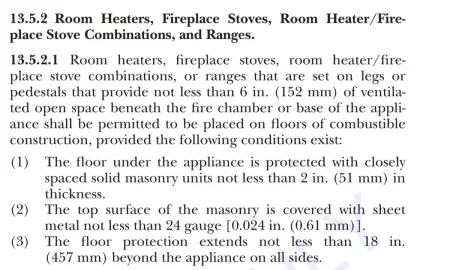

This is what NFPA 211 says for an unlisted device with 6" or more air gap under it.
You are not installing enough masonry thickness to satisfy NFPA 211.
