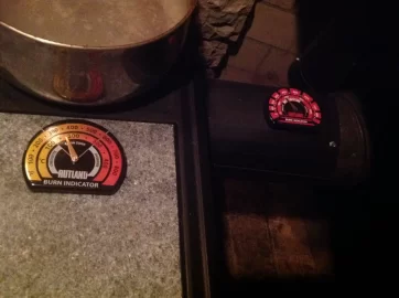

I moved the temp mag. the mag is now sitting on top of the pipe 6" from the back of the stove... Both the stove and the pipe are sitting at 350. What pipe temp should I be looking for at that distance?
I'm not sure how much hotter the flue gases are on the interior of the pipe. These thermometers are really meant for reading on a vertical flue surface. For a vertical pipe the multiplier is about 1.5 times the surface temp. But even if it is 1.25 in your case I feel better about your flue temps. Check it out in a month or so, or after the first cord has been burned. You might be fine. The burn looks great.
