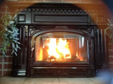

If your looking at the Clydesdale, then look at the Montpelier in the enamel brown it has elegant dental molding and firs up very nice.... [Hearth.com] Hearthstone Clydesdale? [Hearth.com] Hearthstone Clydesdale?

I have never heard anything bad about the Montpelier. There's no reason to think it has a short life, after all, it doesn't have the plagued VC combustion system. It's a good looking unit, I was just funnin.
