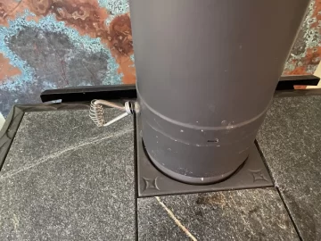

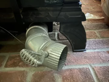

I've been burning a Heritage 8021 since 2012. My set-up includes a flue running about 23 feet from the top of the stove, straight up through a chase on the second floor. Even with a full load of dry oak on a hot bed coals the air control has always shown a significant effect on the fire. However I've never felt it was enough, so after checking door gaskets and all around the stove with a stick of incense revealed no leaks, I added an inline damper to the flue just above the stove outlet which helped a lot. Still a good fire on very cold day might show signs of running away from me. The solution was to mount an outside air kit to the stove and attach a section of 3 inch duct with its own damper.
I'm suspect this may sound extreme to those here with greater knowledge of these things, but it's worked really well for years to produce long burns, no smoke, and a 450 to 550 degree stove-top.
In short, your air control sounds like it needs work. You may find, as I did, that external damper(s) may help.
(that's not a crack in the stove top! just a vein in the stone)
