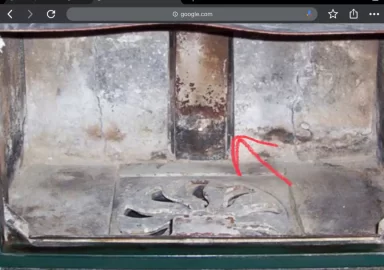

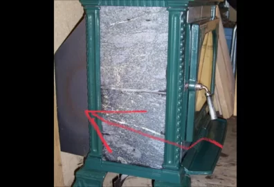

This is not my stove, but found these photos online. My stove has a heat shield ((??)) on the back, like the first photo. And the second photo Shows where the air seems to be coming from, next to that center Column. What is that center column, exactly?

That is at the base of the secondary air supply tube. There should be no air coming in there. Based on the parts diagram, there should be a strap at the bottom of the tube in that location. Is it still there?
Hmmm....not sure! I’ll have to look and see what the strap looks like and then check. And thanks for the info about the secondary tube.
Yes, #54
