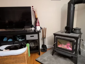

Hi all- Been following for a while but new to group. Just purchased a Hearthstone Manchester stove for a place we are building. I was proposing to put the stove in the corner with proper spacing per the installation manual from combustable surfaces. Just wondering how close is too close for the television shown to the left on the wall. Can't test it for temp and my locations start to get limited as I really want the Stove where we watch TV, my other option would be on the opposite side of the big room or maybe middle of the room.'
Comments/inputs appreciated.

We have a Castleton tucked into the corner as close as allowed, and our TV is located similarly to yours. They're 26" apart and it's completely fine.
I might be more concerned if the screen was squared up with the stove more, picking up more radiant heat. But how we have it only the right edge gets a little warmer. No more than being in direct sun.
