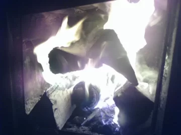

Full blown secondary looks like this, flames licking the glass

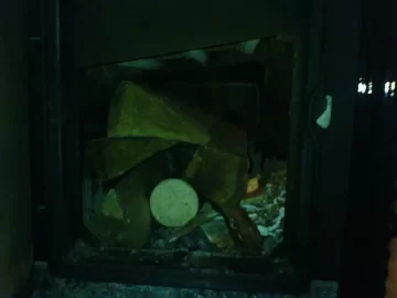

A little less intense secondary

YOur secondary in the video looks very low temp to me. Notice in my pictures there is no primary air coming in from the bottom of the stove.
The first picture would have been with dampener fully closed on a below zero night.
