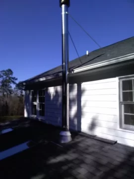

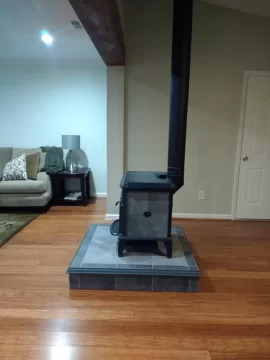

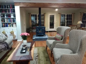

Installation: The unit was professionally installed (see attached pics) in my townhome. We have building permits and were approved by the Greensboro, NC city inspectors.
1) Inside: Selkirk, 6" Double Wall Stove pipe.
2) Outside: Selkirk, Class A Stainless Steel Chimney Pipe. Set up exceeds the 2, 3, 10 rule. Total flue is ~ 21' from the top of the stove to the top of chimney cap.

Hi Folks, just wanted to follow up on this problem from last year. By the time I stated this thread last year, burning season was almost over. Hence, I was basically lefts at step #4, draft test. So, I purchased a Dwyer MARK II manometer, ~ $25 or so.
Here are my draft test results. The tests were all performed on different days to account for the varying weather conditions.
Test #1 = 0.14 wc , Test #2 = 0.18 wc , Test #3 = 0.14 wc , Test #4 = 0.11 wc
Hence, according to the technical note from Hearthstone, the draft should be between 0.06wc to 0.1 wc . Ok, so I am definitely over drafting. Again, I have a 21' Chimney, and live in a 2 story townhome. No adjustment can be made to the chimney height.
After reading further posts/threads I installed a pipe damper in December of 2020.
Here are my test results (30 minutes into the burn with a good fire)
Primary Air Open, Open Damper, Draft is ~ 0.12wc, after closing Damper 0.1wc
Primary Closed, after closing Damper 0.09wc
I have run this test several times under different conditions , and the draft will reduce by -0.02wc to -0.03wc. This is an improvement, but not a game changer for me.
Conclusions: I am definitely over drafting but can't reduce my chimney height. I have added a damper, with minimum success at reducing the draft. One benefit of adding the damper, is that the oven stays hotter longer. But again after 2 loads, I can't seem to get above the 300F to 325F range. Sorry for the long post, but I want everyone to have the details.
