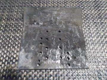

After blocking the two bottom holes with round magnets, I also closed off some of the wear plate holes to improve burn efficiency on my 25- pdv. If you look at the burn center on the wear plate, you'll see that you will get a circle of burning pellets in front of the auger tube, with ash all around it. I blocked off all of the wear plate holes around this circle with stove cement, to force more air up through the wear plate. You can use high temp foil tape underneath, to block the holes temporarily first. If you like the results, you can use the stove cement.
What a great idea. easy enough to try. Thanks
