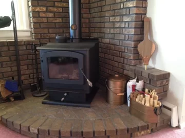

:)Thank you very much for your reply. And by the way Happy New Year to all at Hearth.com. You guys make very good sense. I have an Englander NC 30 and would probably not need it. Thx to you all again Such a great website Here is a pic of my wonderful stove!

Skywalker, Nice hearth! Just, why didn't you remove the baseboard heater??
