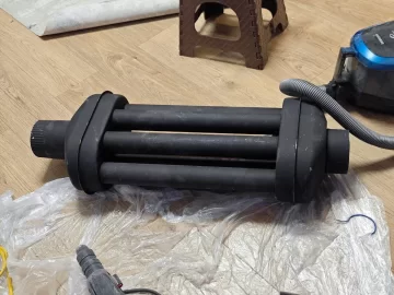

I am interested based on experience of others to know which heat pipe reclaimer works best ( which pipe will extract more heat from fire without loosing it etc )...I am giving 2 examples here
[Hearth.com] Stove Pipe heat reclaimer
This one with a small fan on bottom side or this other with 6 small pipes which we call it as pipe radiator...both 1 meters long in diameter Fi 200 ( 200mm )
Thank you in advance if you have other ideas which work better please let me know.
This one with a small fan on bottom side or this other with 6 small pipes which we call it as pipe radiator...both 1 meters long in diameter Fi 200 ( 200mm )View attachment 321431

Uhhh. What unit is this
The one in the 2nd picture is the best…
…and is similar in concept to a much older Rosemont Radiator design…and were used with anthracite coal (light gray non-combustible fly ash…aka no black combustible soot or creosote from burning wood).
Not to be used with wood….as it’s a creosote monster.

I want to extract more heat from pipes so lets focus in type of pipes which work better.
To the OP…don’t confuse what you have with the Rosemont Radiator. Anthracite coal and wood, as well as the draft required for each are at opposite ends of the spectrum.
An Anthracite fire and a chimney burning anthracite doesn’t need much draft and therefore those people of that time period and those using the same stoves today can get by with far less draft than a wood stove/fireplace needs.
I will concede something like this would work far better on a fireplace chimney than it ever would with a stove chimney because so much heat is lost up the chimney of the fireplace and that chimney is hotter than a typical stove chimney would run.
Still, I wouldn’t recommend using it simply because cleaning it will be a nightmare. If you’re dead…because the thing gets clogged with glazed creosote and burns your house down, then there’s no cleaning nightmare to be had.

Do you have any idea which stove pipe is best to reclaim the heat ?
Neither of them should be used on a wood burning appliance. Bholler is a certified chimney sweep. Listen to him, he knows what he’s talking about. You’re trying to reclaim heat out of a fireplace that’s designed for ambiance and not to provide any actual heat to the home.
If you wanted to heat your home with wood you should be using an actual wood stove or wood stove insert.

Everyone is giving you good advice. Your current chimney is a recipe for disaster. There isn't even a way to sweep the chimney without disassembly, and the exchanger still can't be swept.
