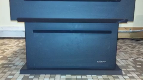

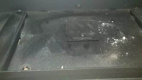

Hey guys, came upon this post as i have a heatilator ps50. I dont mean to hijack but had a question as well. Dexter you say the cab has no damper but im not sure on the ps.. Removing the ash box there is a hole about 2x2 which has a metal plate beside it that i can swing to make the hole smaller. Thinking this isa damper but changing how big the hole is i can see no difference.
(broken link removed to http://mainestoves.com/pdfs/manuals/heatilator/PS50.PDF) On page 7 it shows the combustion air damper. I see pretty much no effect when adjusting this...
Also one other question. I removed my burnpot to clean it as it was getting some really hard build up on it that i couldnt get off. So i removed it to "chisel" the junk off and that was from barefoots. The burnpot has a white fabric like gasket and when removing it the gasket held on the the stove and the pot. So i adjusted the gasket while putting the burn pot back in. Will having a a bad gasket kill or impact the fire in the burnpot. If so i think thats what mine is doing as it seems i cant get a good falme unless i have the feed pretty much opened all the way.
One other question regarding the heatilators if Eric can chime in. Where is the combustion blower. My method of cleaning is after arond five bags i shut it down or let it run out, vacuum all the ash from inside the stove, dump the ash box, remove any clinkers in the fire pot and the try to get any hard build up of the inside of the fire pot. Also i take a hand broom and clean all the ash that has accumulated on the inside walls and remove the back plates to get any ash behind as well. I have removed the blower circular fans (that blows out the hot air) and cleaned them of dust and debris and then behind the back plates there is a hole that leads to the exhaust. I set the vacuum to blow and blow out and dust and ash that has accumulated in the exhasut trail as well as removed the term. cap to clean any settled dust. The one thing i havent cleaned as i dont know where it is is the combustion blower. I can see the exhaust blower (havent removed that) and the hot air blower but i am not sure if i have or where the fan is that pulls air into the stove for combustion....
The exhaust blower is the combustion blower. Its the blower directly connected to your venting. It blows the exhaust out, but "sucks" air into the stove (via burn pot).
Your Burn pot gasket needs replaced if its torn or damaged. That will create an air leak and lead to burn issues.
As to the damper. If its not external (and mentioned in manual), then I dont know if its meant to be played with? If its inside the ash compartment, its not meant to be adjusted while running....... So if its really a damper or not???? I will let Eric answer that.
Can you take a pic of this area?
Edit: looked at manual... It is a damper. But prob best adjusted when not running? IDK. Kinda wish my Quad had something like that. Even if its that vague. Its something.
they do state the damper in the manual on page 7 (broken link removed to http://mainestoves.com/pdfs/manuals/heatilator/PS50.PDF) But it seems useless as there is no gasket between the ash drawer and stove. So air could get sucked in from the ash drawer area as well essentially adding more even if the damper is closed
I will post a pic. Also like i stated i just blow out the fly ash and such from the exhaust trail but havent removed the blower. Will the efficiency be reduced as time goes by and im not able to physically get in there and clean it?
Pics following
"damper" is inside below ash drawer
