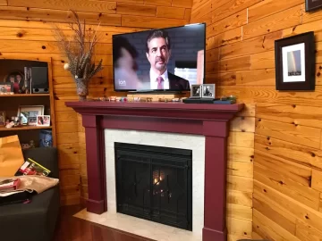

Here's ours.

How will it be installed?
Can you recess it into a wall?
Can you have a corner installation?
Here's ours.
The builder who is doing the other houses is framing them out into the room basically. I wanted a corner install, but at this point that is not an option unfortunately. We were basically told that we had to frame it into the house, but now I see a comment you had made a few years ago about a wall cabinet. Your set-up looks great! Right now we have a flat exterior wall, and we have a gas line stunned out into the center of the wall. Does heat n glo still offer a cabinet we could use with the 6000 series? If we went that route, would we have to build any kind of frame for it or would we just have to vent it and hook up the gas line? Which we would have a professional do.

The cabinet will have a larger opening than the size of your fire place.
If you look at the pic of ours, You can see the marble "surround,"
which consists of a hearth, 2 legs & a header.
The surround fills in the gap between the mantel opening & the front of the fire place,
with a small overlap ONTO the front of the unit to make sure the look is correct,
& there are no gaps uncovered. Show my pic to your builder. He will know what
to do, based on the unit you choose & the mantel & surround you want installed.
