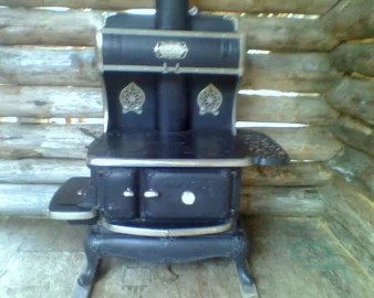

This is my 1908 Amherst Bee which will be in my log home . I plan to cook and heat with it when we move in about 3 yrs. Kind of a novelty , but it will be functional. Why upgrade from the Bakers Choice? Need a larger stove?
