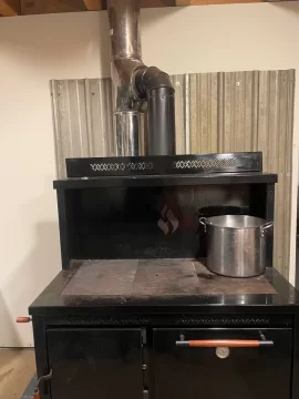

New member here. I have the heco 420 stove in a newly constructed house. I have 25 feet of 6 inch stainless steel chimney pipe above the top of the stove. My problem is that this stove spills smoke out the door when starting fires or reloading with wood. Have you had this problem Heco 420 girl?

Simple question first, is the oven bypass open (cook mode) when starting or reloading the fire?

Nice morning here 6deg F. Everything is open. I grew up with an old glenwood cook stove so i know how they can smoke with the oven bypass closed. I have never seen a stove smoke like this one but if others dont have this problem there must be something wrong with my chimney.

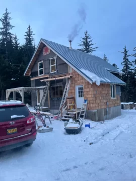

This stove wants a strong draft so a 25' flue should suffice. Is the chimney interior or exterior? Is the stove in a one story addition to a 2 story house?

2 story house with basement. interior chimney. Opening the window doesnt help at all. I had this problem while the house was under construction too.
Is the stove on the main floor or basement floor?

The stove is on the main floor, there is a cleanout in the basement. Good find with the video! She is having a way different experience than me. Hard to tell whats going on with her chimney but there must be something wrong with mine. There is not a screen on the cap.

The clean out may be leaking. Seal it and see if the smoke issue goes away.

Good suggestion. Leakage could affect draft. Seal the end cap with silicone adhesive.
If that doesn't work, I'd consider eliminating the double-90º turn combo at the tee and soften it by replacing the tee with a 30º chimney elbow and connect the stove pipe directly to it.

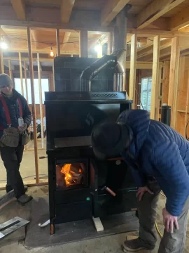

I blocked the chimney just above the cleanout and it didnt seem to help. I used to have it set up like this picture and i had the same problem.
I have considered raising the t in the stainless pipe so the smoke can rise a bit Higher in the single wall pipe before it goes into the 90. Not sure if that would help.
I am reluctant to eliminate the cleanout because it is pretty handy.

Blocked how?
Airtight seal? That is what you need.
Yes, having a larger initial rise before elbowing helps too
Clean outs are often not well sealed.
If you can put a bead of silicone there (that you can cut open to clean if you have to), that'll help.
The point is that your chimney creates draft (suction on the stove). That is the engine that runs the stove. But if part of that suction gets satisfied by air leaking in below the stove at the clean out, you won't have enough draft and can get smoke roll out.
A rag definitely is not a good seal. Securely tape a plastic bag over the end of the cleanout to seal well.

The house is kept well over 60 degrees usually in the low to mid 70s. The cellar where the clean-out is stays much colder, usually between 45 and 50 degrees.
I wrapped and taped a plastic bag around the cleanout and taped all the joints in the insulated pipe. The stove smokes as bad as ever.
I also switched to some different wood. I had some spruce that was about 20 percent moisture. The new stuff is hemlock and birch thats about 15 percent moisture. The different wood didnt change anything.

Nice place. Yes, pulling the cap, temporarily, might help. Be careful up there. If pulling the cap off does make a big difference then there is an expensive cap called VacuStack that may help. The rooster-tail, vaned caps are good for high wind areas. Is that an issue where your house is?
What brand chimney and cap was used?
For most part, you've done every thing right. I asked about the interior temp because draft relies on the temperature differential between indoor and outdoor temp. In the picture it looks like insulation has not gone up yet and everyone was in parkas so I thought the interior might be on the cold side.
