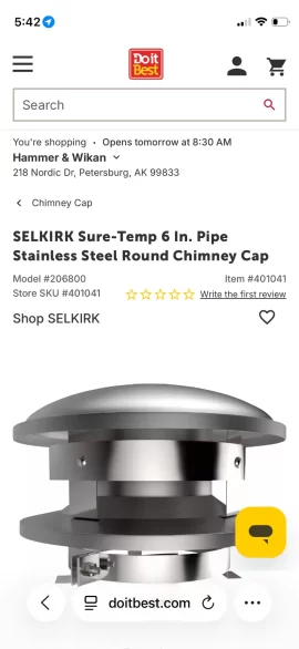

She suggested a different cap. And yes it is windy here and the wind seems to swirl around a lot on my property. Ill look into vacustack but the vaned ones are popular here so maybe thats the way to go.

Great, that's progress. It's hard to tell what cap is currently on the chimney. What brand chimney and cap is this?
Its just the normal selkirk cap

The wind band is a bit restrictive. It's probably not the issue, but if there will be a dry spell, then it wouldn't hurt to run with it off for a few fires. However, if wind is the issue, then a chimney without a cap will be the most affected. Another issue may be the house location where the geography creates a pressure zone over the house or one that directs winds down on the roof.
