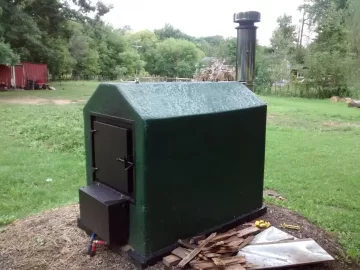

well the heater has been delivered installed and hooked up...the company has also been replying to every text and call I've made very quickly. They have gone out of their way to find me parts I need for my back up gas boiler. the company is overworked and needs more employees..the heater fired up on its break in fire very well it heated the water with only a small campfire kind of fire in the fireplace up to operational temperature oddly the in side kept warm water and hot in side stove for six days after I last stoked it..three split 12-15 inch leanth logs 10in in diamiter thats using only one sixth of the firebox.but yes its middle of summer as well. as far as wood consumption for this unit 3000 series I do not know yet. it looks well in the yard and have had many compliments...the company is yet to come out and add the entries required by warranty as I have not made a date yet. so far with what I have seenI would give them a 5 star rating for company service. as for this winter will tell on the actual working of the wood stove outside.I haven't had any bad incidences with them for the stove yet still a thumbs up needless to say I'm excited for winter. Stay tuned for more with pictures!!!!

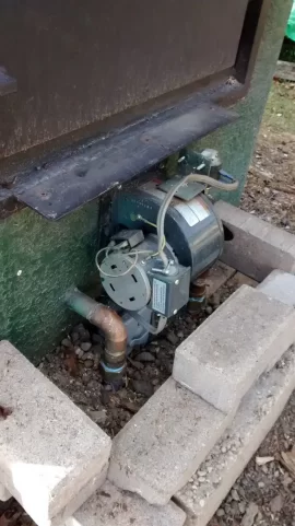

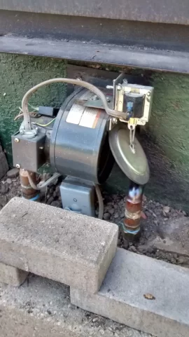

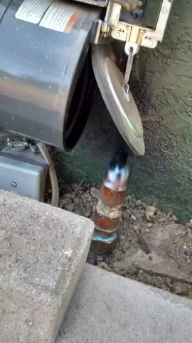

Im not saying its bad. But there's a few oddities I've seen. The system works well for my home. I haven't had to may issues, only that air in the old boiler lines not moving and needing a bigger pump. Some tweeking will happen after the warranty is off in two years. I think a combination of natural aspiration and blower should be used.. It doesnt always need a leaf blower on the fire to gain a few degrees.. Eats the wood quick. Its easy to clean and such.. The blower kicks on and starts back draft on wet wood dry wood big wood or small.. Its heat in the box is to much for the little hole the air blows thru.. I've opened the rubber flap manually on side of blower cage and it gains heat well with out force.. Or cho chooo chooo affect.. It does back draft through the squirl cage blower. Gumming it up with creosote... In time will need replacing... I do need to get extra parts on shelf.. As far as safety yes on my boiler in home the gas unit has a 30psi pressure valve and a air bleeder... The only thing I see on the boiler any were is a air bleeder on top of stove.. Becides that nothing.. More pics soon to come..how ever that being said these issues are mine and not due to the boiler 3000series it does work dam well to heat this big house..
Good place to plant for early Tulips.
them lines are missing something...........!!!
Yeah, what the heck are they doing right there where your feet want to be? And the big box too.

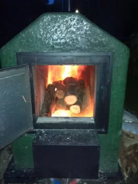

[Hearth.com] Heiss Masonary Wood Heater/Boiler Easy[Hearth.com] Heiss Masonary Wood Heater/Boiler [Hearth.com] Heiss Masonary Wood Heater/Boiler fellas. This stove is by no means perfect yes the black box is a pain in the but its constantly catching chips and in the way.. The inside is hot as hell. Ive read up on it yea lots complain about cement cracking.. I burned for three months now and no cracking has occurred.even if it does nones complained well the crack is leaking water.. Or any such issue. The out side of this thing is a cool light warm its only draw is this dam blower.. Its started making noise this morning from the chugging backdraft ..I've done as the comp said and put bigger wet logs in and she still chugs. I think its two much air force. A slower fan maby needs here.
With most wood burners the owners are making tweaks and mods where the manufacturers could have gone further but didn't. Combustion air control is a rather important aspect in getting efficiency to its sweet spot. It looks like you could wire in a fan controller pretty easy, just want to get one with a sufficient amp rating for the blower. My thinker is wondering why the blower is laying at ground level. Mice like warm places and also enjoy a good meal of wire insulation, thinking the whole blower and piping thing could be better located.
Yeah that blower could be relocated easy enough if you are so inclined, and that would give room to insulate and cover the piping. Keep us posted.
The company told you to put bigger "wet" logs on the fire to help with the fan problem? Oiy...
I hope you'll stop in throughout the winter and post updates. I'd also be interested to know how warm the outside of your boiler is during a peak burn. Do you have a thermometer you could tape to it for an hour or two?
