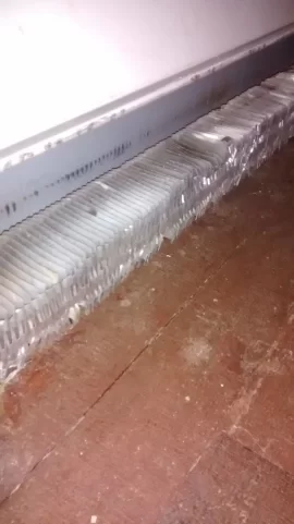

This 3/4 copper line with aluminum fins runs through my entire 5300ft house. 8 zones

Ok, that's not what is more accurately known as 'radiant'. That is ordinary hot water baseboard that works more on convection than radiant.
Man that's a huge house, and must be quite a load - would be for whatever you're heating with. There are options for getting more mileage out of your baseboard, and your hot water. You could add more finned lengths in places where there is none, or add some that is naturally more capable. Slant Fin makes one type that will get more heat out of the water - I forget the model of it, but I will be checking it out for next season to try to get more mileage out of my storage. I think it must be bigger in the fin department. You could also get some used cast iron rads, the old fashion type, and plumb those into your zones. That might be the cheapest. Those things pump out heat. Then there are panel rads, that would likely work & look the best, but would be the most expensive. IMO if you NEED 185 water to keep your house warm, I think the system was underdesigned and they didn't install enough radiation when the system was installed. I think I got lucky - seems to be the opposite here. My house doesn't seem to start to lose temp until my water gets below 140 or so, depending on the day. This last cold spell my storage was down to 130 or so sometimes before I started burning. But I'd still like even better performance.
