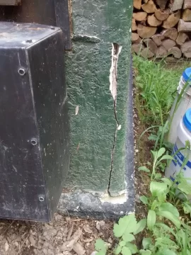

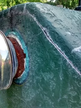

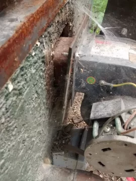

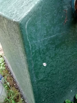

Just a few pics of 5 months of use.. Tell me I'm wrong for being upset.. All cracks smoke the fan falls out on the ground and door bairly shuts. And leaks allll the way around..
Heiss was nice for the first problem I had.
Then they were mad I asked why its cracking.
Then pissed and hung up on me when I said the blower keeps falling out..
Welp guess Amazon won't be backing this one up...
