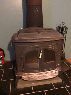

Yes I know, new guy with a old stove. That said I’m not new to the lifestyle, my father had a ”home made” stove that was my job growing up to run effectively. A few Uncles had stoves and I took up the family tradition. I’ve been running a Vermont Vigilant for years now in my own house, and couldn’t be happier/prouder. I’ve also made 2 neighbors convert to the beauty of self earned local wood heat. That said, I’m no idiot and am quite handy, but also recognize certain limits.

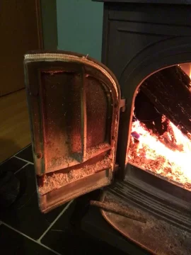

Knowing that I run a older Vigilant, and I make her earn her keep on locally sourced hardwood, I realize when a workhorse needs a new saddle. I’m thinking about breaking her down and giving a needed reseal/gasket job. Also looking for a solution to the recently broken interior front door cast iron glass brackets.
Is there anyone out there making new doors or more importantly new glass retainers? I really like the added glass protection they provide. Anyone?? Thanks!!

Oh, sorry, I’ve see the new style stamped steel glass retaining brackets and am less than impressed. Really like the idea of the old cast iron brace that runs down the center of the door windows along with the edges. I’m striking out to find that replacement. I’m contemplating making my own brackets but if another wood heating guy has a fix before I start cutting and welding, I’m all ears!!! Thanks again!!

So if you go to the Woodmans Parts Plus website and follow prompts to V.C., then VIGILANT 2 ( which yours is not but don't worry) you'll find llisted stainless steel glass retainers which replace the old cast frames. Don't think they're available any more. Use 1/4" rope gasketing, boom. Done.
defiant3
Dec 23, 2010
1,020
No. NH
Screws will break more than likely. If it's a nusiance, take the new parts to your local glass company, see if they'll handle it.
