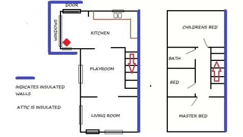

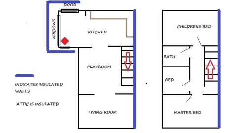

Buying a pellet stove and putting it in the kitchen which is the coldest room, and the upstairs staircase is also in the kitchen, the stove would be cornered pointing in that direction.... I have included a diagram
The stove is in the kitchen n the corner... i am wondering if this will HELP... I drew this up to hopefully help figure this out better, I am concerned with the circulation getting up to our childrens bedroom, so we considered cutting a floor/ceiling vent in the kitchen area where the boys room is, so the heat rises through... will this work, again given our cirucumstances.... our oil heats our home well, its just very expensive, even in the coldest days/months it is able to keep our house at 72, its running all the time, but it keeps it maintained... the inslulation cant be THAT bad... PLUS the other side of the house is not only completed insulated with blow in BUT they are also heating their side, so we are hoping that helps keep the warm in too....
Is the placement ok? Willl it be able to reach the Living room and upstairs??? I am worried about the windows and our childrens rooms, we can always use a space heater for upstairs, we can install fans, etc.??
Looking at your layout, is the wall between the stair and playroom open? If so, this would appear to be a much better location for a stove.
If not, I would still think seriously about it. Centrally located to be able to get heat to all area of the downstairs. Could look at a transfer grille / fan in the wall at the stair.

-I would probably look for a decent used stove and then try and insulate. I also would put it in the playroom area so that the heat goes into kitchen and upstairs.
I agree that the playroom area looks to be the best location,.. with passive venting going through the stairway partition wall to allow heat up the stairs.
