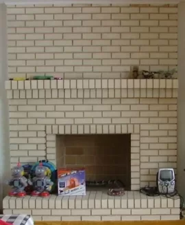

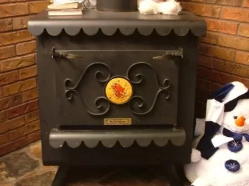

We are getting ready to move into our permanent home in a couple weeks. The home was built in 1980 and has a fireplace that has never been used and a Earth Stove that has been used but probably minimally in the last 10 years. I had the home inspected and the fireplace and stove were found to be in very good condition. It is kind of strange where the stove and fireplace are situated...one in the living room and one in the den about 20 feet from each other. I probably won't be using the fireplace anyway or I may put a pellet insert in it.
A couple questions:
How efficient is the Earth Stove? Fair? Poor?
There is no damper installed. Should I install one?
It does not have a grate. Did it come with one?
I noticed on other posts that Lennox bought them out. Can one of you tell me the model by looking at the pictures?

I can't tell you the model off the top of my head but that's one of the pre EPA models and isn't very efficient though they do throw alot of heat. I don't believe they came with a grate. Lennox did buy them out and now the brand doesn't exist at all anymore. I would determine the need for a damper by how much control you have over the fire. If the chimney has really strong or excessive draft then a stove pipe damper might be in order otherwise it's just a creosote trap. That fireplace is begging for an insert. I've been very pleased with my pellet stoves performance, though having to stakeout the the hardware store parking lot for the the pellet truck has gotten old this year, but hopefully that's alleviated this year with ramped up production and a levaling off of demand. I am going to buy 4 ton this summer (after I build the storage shed for them) and shouldn't have to worry about it anyway. The new Enviro Empress pellet insert is going to be awesome they don't have it on their website yet but I have brochures and it is a good looking unit. Also check out the Avalon and Lopi products they're good. I have a Lopi.

What should I expect to pay on an insert and all the stuff to go with it? Ballpark?
If you were at my shop you'd be looking at 2500-3200 for the insert. 225-325 for the liner and around 400 for the install. Your prices will vary some depending on your exact location.
