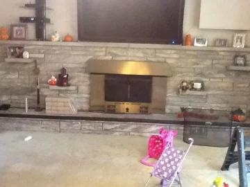

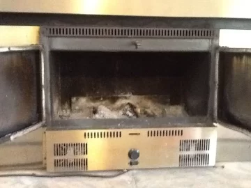

I hope I am making sense if not please let me know amd i will take pictures of what i want to do.
A picture would be good. If the insert doesn't have a traditional exhaust it might not possible to attach a liner to it. I haven't seen one with multiple holes like you are describing. Adding firebrick, liner etc. will help a little but not much. It will make it a whole lot safer though!
By the time you pull that thing out, buy an 8" liner kit and most likely a custom adapter for the stove, you will have a lot of money tied up into it. A new stove will only require a 6" liner, you can apply the saving toward an efficient stove.
You have thermal mass around the insert, so added firebrick will not help much either with heating your home or longer burns. I don't think you are going to be able to improve much with your current stove where you will get the best bang for your buck. I would think about a replacement. You will save the money back with lower amount of wood needed to heat your home and the labor involved. A new stove will also be much safer for you and your home.

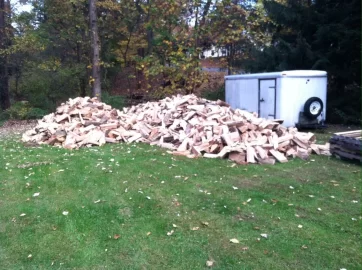

So here are some pictures how many cords of wood would you guys say that is? Also some pictures of my insert just to give you a idea of size thats a 65 led tv above it..
1.5 -2 cords?
Please don't tell me i got robbed i bought 9 cords of wood.. 3 seperate deliveries with 15 yard dumpster..
[Hearth.com] Hello eveyone
Could be the angle of the photo, but there aren't 9 cords there. 9 face cords maybe if the pile continues on past what we see. But not 9 full cords.
PS: cute kiddo
Reactions: Adios Pantalones
Lol i got the little on in fromt but i got 2 piles like that and one more closer to the house that about half the size.
Those are about 20 feet long 6-7 feet high and 4-5 feet wide.
I will take better pictures of the wood and firebox showing measurements.
