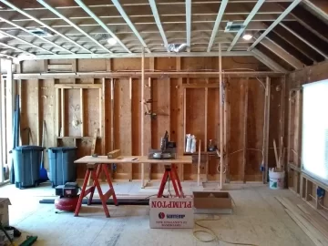

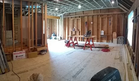

Quick background: We are in the process of remodeling a 21x25' space that was formerly an in-law apartment, and opening it up to the main house. We are taking up one corner with a 10 x 10 area for a bathroom and hallway, other than that it is open with 9' ceilings. We have always wanted a fireplace and have settled on a zero clearance. A local installer I met through my electrician suggested a Majestic Sovereign which, installed is within the budget. My wife likes the look of the radiating kind, and I wonder if we would be missing out on the circulating features of a model with a blower. I've read enough on here to understand that actual heat expectations should be low, and it would be more for ambiance. My neighbor has a Heatilator Icon 60 that looks great and hes happy with it, my installer tells me it comes off the same line as the majestic. I'd go for the icon 60 but he says the pipe + the clearances would be 17+ inches so would have to cut a roof rafter (which i'd rather not). IF we decided to bump up the budget for the sake of getting something that heats better, I was looking at a Flame Monaco, my wife doesn't love the look of it but will go with it if it makes the most sense.

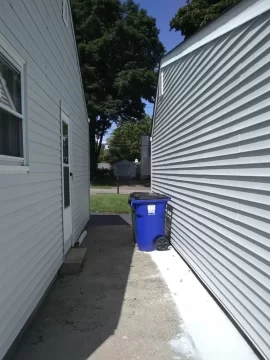

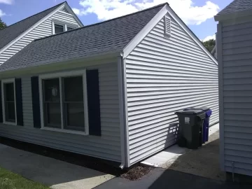

To the unique issue: We are trying to figure out if we should just build the chase inside and go through the roof with the chimney, or push the unit through the wall and have an external chimney chase. Pros: I can go with a larger size like the heatilator 60 because the larger flu pipe wouldn't require cutting out roof rafters for clearance. also no intrusion into the room & no going through our new roof Cons: Additional cost of Building it and siding it, and it would have to sit on the ground.. Part of this project was that we had to bring our foundation up out of the ground because of water issues and the framing sits inside of it, top of framing = top of foundation wall. So there's no way to sister into the floor joists to have a cantilevered box outside. The chimney chase would have to sit on the ground outside on what is now a 6" thick sidewalk.
Would you cut the sidewalk away and pour a thick pad, with a footing? Or just build it inside?
Any help or tips or opinions would be greatly appreciated, thank you!
There's a few pics attached. One of inside with where the fireplace will go mocked up with 2x4's. One of the front of the house showing the alleyway the chimney would protrude into (represented by garbage cans) and one coming from the other direction to see if it comes out too far into the alleyway.
