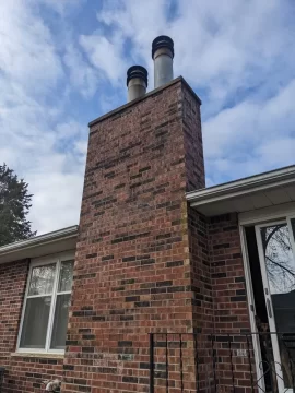

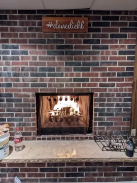

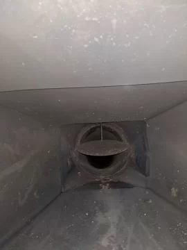

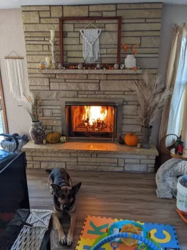

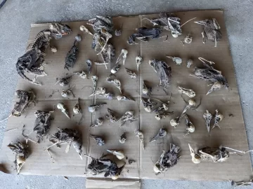

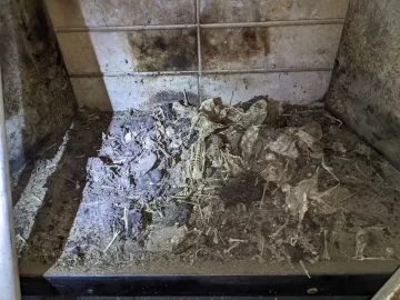

So I finally got both of my fireplaces up and running, a pair of Heatilator Mark 123 model 3036, and am looking for some guidance. When I bought my house, I was told both fireplaces were "capped" because they were unable to open the dampers. After a little elbow grease and some work with a pipe and hammer, turns out they weren't capped, there was just about 50 years worth of dead birds and squirrels sitting on top of that plate. Don't know if you've ever had skulls rain down on you while your stuffed into a confined space, but I wouldn't recommend it. Anyway, man do these Heatilators suck - literally. I'm barely getting any heat and have to run the damper wide open to keep the room from filling up with smoke. What are my options here? I know the unit goes up quite a ways past the brick/stone façade, but can I cut these things out and replace it with a free standing or insert? The stove pipe on the roof is about 14.5 inches in diameter on the outside, with the inside pipe around 8.5. I'm just worried about these things cutting loose and taking an arm off or worse if I try to remove the stove. Any help/suggestions would be greatly appreciated.

I think it's just a place where the veil between bird worlds is thin - after cleaning that mess out, I had another bird work its way down there. I popped the caps off the chimney and lined them with some stainless steel mesh so hopefully that does the trick. As for the dog, he is under the impression that every piece of wood brought in rightfully belongs to him and can be carried wherever he believes necessary, so we're working on that.
