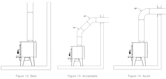

Draft is weak and challenged by the installation. A basement install with three 90º turns in the flue path within a few feet is bound to be troublesome. The basement sounds like it may be a negative pressure zone if opening a nearby window helps. An outside air supply, not directly connected, but terminating a few inches from the stove's intake may help that.
Before changing the stove, try changing it to top vent and eliminate the bottom elbow. You can also eliminate the second 90º turn by using 45º elbows to create an offset. This should make a notable improvement. These changes together with fresh air may help enough to make the situation manageable. It's a good heater, but it needs proper draft to perform well.

Maybe I described it poorly but I’m not sure where you are figuring 3 90s. There is one 90 to the chimney liner.

Ah, the fireplace was not in the description. I made the mistake of assuming the 6" liner was connected to a thimble.
That makes a solution more of a challenge. Rear venting doesn't help. There are multiple factors that can make the basement a negative pressure zone. A common one is air leakage out of the house on the floors above. Second story leaky windows, attic doors or vents can cause this. The other things are competing appliances in the basement like a furnace, oil/gas hot water heater, clothes dryer. Bath and kitchen fans will exacerbate the situation. So will a radon system. Sometimes the only solution is to pressurize the basement with an HRV or move the stove upstairs.
