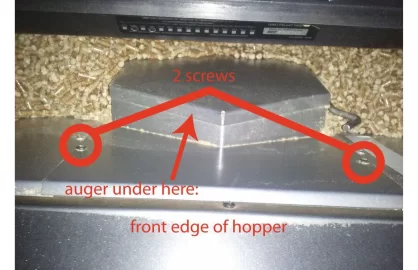

You access the auger through from inside the hopper, no need to move the stove. There are 2 Phillips screws (one on each side) that hold the cover on. Be careful pulling the screws out so they don't fall down the hopper. Once you take out the screws, the cover slides up towards you. You can see the auger assembly once the cover is off.
While you are in there, you can also check the vacuum hose (disconnect from auger and from vac switch on back of stove) to make sure it is clear. If the vac hose is blocked, the auger will not feed pellets.
when you are looking into the hopper, the big boxy looking section in the middle is what covers the auger assy. The feed adjustment thumbscrew screws into the right side of the cover. This (the boxy shaped metal cover) is what you want to unscrew and slide up and out of the hopper.

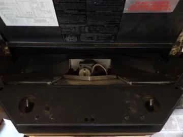

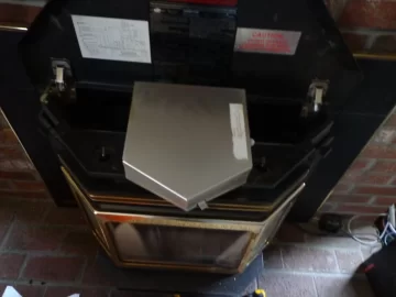

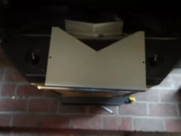

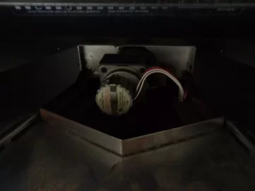

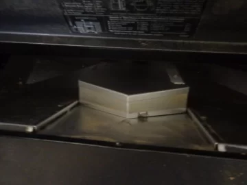

That looks more like a rivet of some sort. On my insert (built in Jan 06) the screws are about 2 1/2 inches down from the front lip of the hopper. Both are black Philips screws.
  • [Hearth.com] HELP! Auger Jammed in QF CB insert
Have more with the auger out if you need them.
