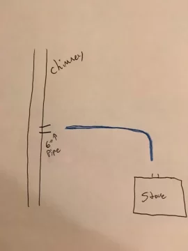

Hooking up a blaze king princess to a chimney in a basement. the chimney has a 6" pipe stubbed out of it. I will need to come out and turn a 90 down (I'll probably use two 45s for better flow) and into the top of the stove. Im wondering exactly what materials I will need. Im going to use 24 guage single wall, this is only a temporary set up (3 to 5 years most likely). ive never installed stove pipe before.
-Will I need exact measurements and precise lengths cut or can I piece together some straight pipe/make my own cuts to get my desired lengths? (from chimney stub out to 90 and from stove to 90)
-Do i need a special adapter to connect the pipe to the stove?
-Do i need a special adapter to connect pipe to stub on chimney?
-how do i join pipe peices together? (some kind of seal, etc?)
-Is the pipe that I need going to be generic that can be bought at any store ( home depot, etc) or will I need blaze king specific parts?
Again, this is only a temporary set up and the only thing I will be taking with me when I leave is the stove so I want to keep it as cheap as possible, without sacrificing efficiency or safety.
Here is a picture to show what Im looking for. The part drawn in blue is the piping I need to install
