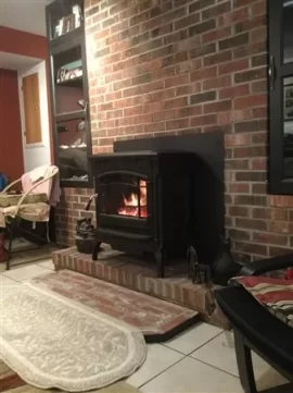

If its a standard brick facing you could grind out a mortar joint higher and put a new lintle bar in then remove the brick below the new lintle and put any stove the will fit with the hearth. Or if you have a big enough hearth u could put a stove like a manchester in and rear vent it with connector pipe and tee into a liner. Personally i would just put a boston 1700 insert in. It will fit your dimensions no problem
You can also make a steel panel on a rear vent stove to cover up the opening and stick more of the stove into the firebox behind the panel only problem with this is it makes it a little harder to clean and you trap some heat behind the panel but it lets u work with less hearth and makes it look clean
