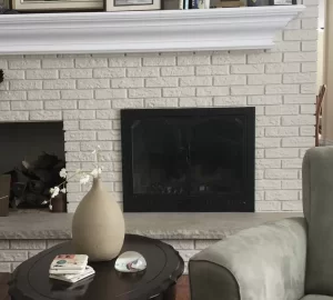

I’m struggling to find one or more examples of wood inserts that fit my application. More troubling, when I think I find one online, I can’t seem to find any showrooms to see it in person.
my opening is approx is 31.5Wx25H. the back is rounded so it’s 20” deep at the bottom and 16” at the top. Further complicating is the distance to the mantle. 17” to the bottom of the short side of mantle. 24” to the long side of the mantle. Mantle is 9.5” wide at the top and 4” wide at the bottom.
Some units which I think may work have fireboxes that are only 1.3-1.8 cubic ft.
we were set on the Napoleon EPI3C….but didn’t have clearance to the mantle as Napoleon includes the surround in its clearance requirements. it had a slightly larger firebox (1.8?) but looked very small in person.
then we looked at a regency Altera 1150. Its firebox is even smaller! And we can’t find one to see in person.
Someone suggested a Pacific Energy 2.5 neo. Seems to big and the smaller neo seems REALLY small.
my questions:
1. Is it normal to purchase these units without seeing them in person?
2. is my opening particularity small?
3. what size of firebox should I expect?
4. is there a blank schematic template on this site to record the various measurements?
id hate to have to move my mantle, repair holes in the brick and likely repaint the entire brick surround.
