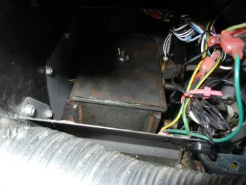

I have Harman P68. I cleaned the fines box this afternoon, and was unsure that I replaced the cover correctly. If the cover fits nice and flat against the seal, the center of the wing nut is about even with the bottom of the cover. Seems not quite right. If I position the cover all the down the wing nut looks normal over the slot in the cover, but the cover doesn't seem to seat nice and flush, as if the top of the cover touches the frame before the sides seat. I elected to place the cover this way, as at least the wingnut is at the top of the cover plate slot. Is this supposed to be an airtight fit?

I have Harman P68. I cleaned the fines box this afternoon, and was unsure that I replaced the cover correctly. If the cover fits nice and flat against the seal, the center of the wing nut is about even with the bottom of the cover. Seems not quite right. If I position the cover all the down the wing nut looks normal over the slot in the cover, but the cover doesn't seem to seat nice and flush, as if the top of the cover touches the frame before the sides seat. I elected to place the cover this way, as at least the wingnut is at the top of the cover plate slot. Is this supposed to be an airtight fit?[/quote
This is as it looks in a pc45
  • [Hearth.com] Help! Harman problems!
