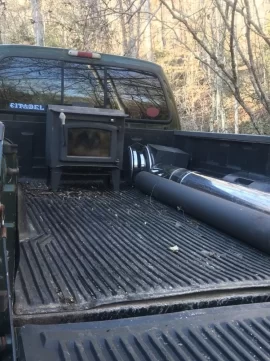

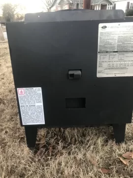

    I️ can’t find any manuals online just catalogs. I’m trying to figure out if this back piece is supposed to be like this.

    Is this the Windsor? I've not seen this. It appear to be a Dutchmaster stove by Monnesen. Can you post a clear picture of just the full UL label on the back of the stove. If I took a guess the small hole is for the secondary intake and the big hole is for the blower option?
