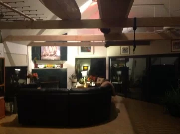

MarkinNC, thanks, good insight. I can't do a mock-up "yet", because I will be removing the corner wall where the current fireplace is, which is where I will put the freestander. I'm going to leave the top part, and put some decrateive (and heat shield) stone on it and the underside, but the bottom part under the white shelf/strip is coming out. And your right, LI stoves sales is going WAY up!! Each showroom I walk in, they tell me they have been swamped.

What do you folks think of the Enerzone Destination 2.3? 2.3 cu ft firebox, is that going to be large enough? My lean to this one is, I saw an Enerzone (the big 3.4) burning in a showroom, and it really burned nice, seemed well made, and had the simple look I like. But the Destination is even more modern looking, and I really like the log storage under it. I'm just not sure it's big enough for this large, drafty window room??
Keep in mind, this is really not a full time heater, it's more of a nice supplimental heat source, and ornamental fireplace. But I think once i start burning in a stove compared to my current fireplace (which throws very little heat), I'm going to be more on the heat side of things!! ;)

Clearances are a non-issue. After removing the lower part (white part and below) of the corner wall pictured, I have the entire corner which will be durarocked, with a stone finish floor to ceiling. I'll simply place the stove at minimum clearance from each side.
So what size would you recommend, money no object and plenty of space?

I would pick out some models you find appealing that have largish, say 2.5+ cft firebox's. Try to narrrow it down to a few of your favorite choices. Then, create a new post asking for opinions on those models.

Ok, I'll bite,.. About a 1400 sq foot great room with cathedral ceiling. So which type and size would be best?
I had the Quad IR down but after seeing the room I changed my mind. I would go with a mid-sized convective stove. There are lots of choices. You will have to tell us your preference for style and design. For staters look at the Enviro Kodiak 1700 line. If you want it in a nice cast iron jacket, the same firebox is in the Enviro Boston.

My house and preference style as you can see in pic is mostly modern/contemporary.

Hey Begreen: I see you often recommend convective stoves for cathedral ceilings. I'm just curious why. In my experience (having had both with cathedral ceilings) I've found that the radiant stove does a better job of keeping the heat down and warming the lower "stuff". It seems physics would agree. Radiant heat = line of sight. Hot air (convection heat) rises.
Not trying to argue. Really just curious.
