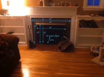

I've attached a photo of the fireplace and here are some measurement;
Opening- 29" tall, 36" widest point, 26 1/2" narrowest point, 16" deep
There is 6 inches of brick around the opening and wood trim around the brick.
The hearth is 20" now but wouldn't mind going a little bigger.
I understand the basic pros and cons of stove vs insert but am hoping for some specific challenges i would face with either based on the layout I have.
If there's any brands you recommend throw that at me too, my local dealer seems fond of napoleon insert..
If there is any other info I can give you to help just let me know.

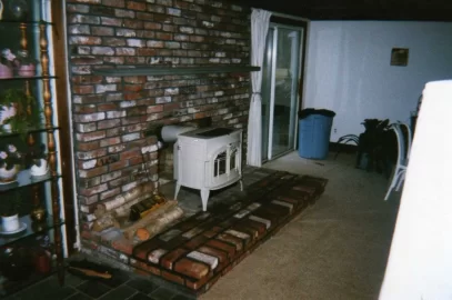

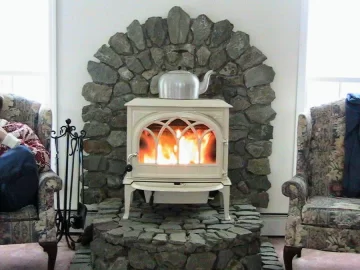

If I had a larger fireplace in a more open room, I would probably opt for a stand alone in front of the fireplace. Something like this.

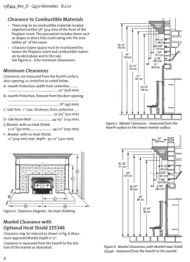

I would shoot for a rough equivalent in stove/insert size. The reason being the length of the burn, not the heat output. I suggested an insert because it might present less installation clearance issues. Currently I was thinking a Jotul C450, but to be sure we need more dimensions, like the width of the space between the side cabinets, the height of the mantel, the thickness of the inside mantel trim boards etc. Here is an example page from the C450 manual for you to look at. It shows the clearance requirements for this insert. Not all are as fussy or as detailed. I'm just floating this one out as an example. Click on the image to enlarge.

Ok so here are some more dimiensions
The brick is 50" wide and 36" tall.
The top of the mantle is at 49 1/2"
The width of the hearth is 57 1/2".
The distance between the top of the bookcases is 59", the distance between the sides of the bookcases is 62".
Inside mantel trim boards are 6" on the sides and 14 1/2" to the top of the mantel.
Thanks for all the help. I think I would prefer a stove but am completely fine with an insert.
I absolutely want to be 100% by the book as far as clearances and am not willing to compromise, which I am sure everyone here would agree with.
Another piece of the puzzle here, I would like to keep total cost of the stove/ insert at or below $3500, as I also need to spend some money getting the chimney re pointed and work on
OK, double-check this to be sure I have it right:
[Hearth.com] Help me pick my stove/ insert
Looks like you have enough clearance to just squeak in a Woodstock Keystone as a freestander, though I am not sure about the mantel clearance requirement for the stove.
