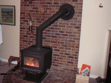

Hello Forum,
My family and I moved into a new house a few years ago with a new Pacific Energy Super 27 wood stove. I'm not super experienced with wood stoves but know a little. I'm hoping someone here can help me out.

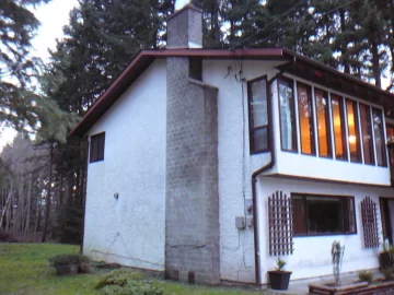

The problem I am having is smoke "back puffing" into the house whenever I try to add wood. I realize the installation is not ideal. The metal round pipe coming out of the stove goes into a rectangular shaped chimney (clay?) which is on the outside wall and enclosed by a larger brick chimney. The exterior chimney is larger than the pipe coming out of the stove so I believe this is negatively affecting the draw and causing the back puffing.
I try to only add wood when there is no flame in the stove. I open the door extremely slowly. I open windows and doors to try and help. Nothing seems to work. Even if there is only hot embers in the stove there is usually a waft of ash billowing out or whatever gases are present. It is also EXTREMELY difficult to light a fire in this wood stove.
The company who installed the stove came to look and suggested that I install a metal pipe from the stove to the roof top. One option was to install the pipe inside the existing clay chimney and the other was to remove the clay (extra $$). Apparently the pipe would JUST fit inside the rectangular clay chimney so I'm guessing the existing clay chimney is not much larger than the pipe coming out from the stove. The guy giving me this advice did not seem super confident about the solution so I thought I would ask opinions here.

Here are a couple pics of the installation.

A cold exterior can cause this. Sounds like it may be dumping into something like a 7" x 11" liner. If so, draft may be hard to get started. Is the stove on the bottom floor or upper floor? A bottom floor install could be further complicated by negative pressure on that floor. Have you tried opening a nearby window a 1/2" to see if that helps?
Taking out the clay tiles so that an insulated stainless liner can be put in is common practice and may be the best solution here. The stove may also need an outside air kit (OAK) if opening a window helps.
I think the installers are very likely correct from your information.

If possible, shut the stove down, let it cool and remove the piping at the entrance to the brick and take some good pictures. Then a picture of the chimney outlet on top of the house, or at least a detailed description would sure help.

The clay liner dimensions I believe are 6x9" or maybe 7x11". The reason I say that is I know it is rectangular shaped and the guy who came to look said if they put in a 6" pipe it would "barely" fit. The clay liner goes right up to the exit point at the top of the chimney. There is no rain cover it is just open.
There are two clay liners in the brick chimney. One for the wood stove downstairs and the other for the fireplace upstairs. We do not use the upstairs fireplace at all. Another weird anomaly is sometimes I can smell smoke coming in from the upstairs fireplace. On calm days if we have a bathroom fan or the clothes dryer going I think it is creating negative pressure in the house and sucking smoke down the upstairs chimney from the other chimney. If I turn the appliances off the smoke stops.

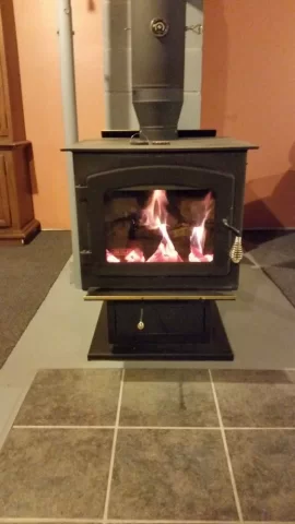

I have a similar setup going into a 7 x 11 clay liner. I had same issue trying to feed a larger flue with only the 6" pipe.
I figured out a fix and have been using it for several years now.
What I did was bought a 6" to 8" adapter to put right on top of the stove and use 8" pipe all the way to the
masonry flue that had an 8" Thimble.
I switched back to 6" just to double check that year and the issues returned.
