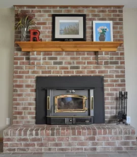

Project complete. Burning off the stink as I type this. Now to learn how this insert burns. Thanks again for all your help. Before and after pics for your viewing pleasure.
