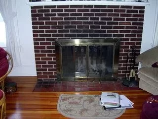

So here's a picture of the fireplace that needs an insert. I've been going through the manuals on the jotul/harmon/lopi's that were previously recommended and I believe I'm presented with a problem. As you can see the hearth on this fireplace is tile, and its level with the wood floor. From brick to across the tile to wood floor is 13". I think most manuals have a min of 16" to combustibles from front of the stove, which tends to pop out from the fireplace some. That's true?
Is my quest for an insert completely screwed?

Add in modifications to your hearth, right off you won't have 16" clearance in front of the loading door of small inserts, or the 18" that the larger ones usually require. You'll probably have to rip out some of that wood floor, that's what I had to do. Inserts are generally only slightly different from one another, no matter which you get they're almost the same package with just a different face. One that puts out 4 grams/hr vs. one that puts out 2 is irrelevant, in a year they'll both be within a split of each other. Others may take only a minute to remove the baffle to chimney sweep, others may take several minutes. Since you're doing it once a year, it really doesn't make a difference that one takes several minutes instead of just one. In the end, my guess you need one with a big firebox size, don't judge them by their max btu's. You'll be looking at it all winter, all summer, you better get the one you enjoy looking at. All other things are practically irrelevant. These things have very little moving parts so it's not like a car where you may end up with one that breaks down all the time. They all are 70% efficiency give or take, it's not like if you get one model your wood use will be 1/4 that of another model (unless we bring the cheapy deluxes into the equation like the Vogelzangs), no matter what you get your wood use will probably be the same. So, get one you like the look of above all else. I've heard some bad things about the VC winter warm large, others say they've redone them and the problem doesn't exist anymore. So, if you look at the VC winter warm large, ask more on here about it and what to look for exactly.
As for insulating, the rim joist/sill plate/band joist area is a must. Notoriously a bad area that really benefits from air sealing and insulating. When insulating your basement either insulate the walls, or the floor, but not both. Many don't understand the unique approach required to insulate basement walls. It's better to insulate the walls if you ever plan on using the space for a living area and, usually your walls have less surface area. I saw they're trying to put into code to ban putting fiberglass directly against foundation walls, it's turned into a mold/mildew haven in too many cases even the ones encapsulated and advertised for basements. The proper technique is to use Extruded Polystyrene against your foundation wall, XPS usually comes in sheets of 4x8, it's a foam board at almost all home centers. Baby blue if made by DOW, Pink if made by Owens Corning and O.C. calls it Foamular. It's not affected by water or moisture, but permeable so they still allow your walls to breathe. Pick yourself up some bundles, save the receipts for the 10% credit, adhere it to the foundation wall, caulk any gaps between any pieces, then use either furring strips or 1x4's and tapcons & a hammer drill to screw them into the foundation (by code it must be screwed into the foundation, can't just depend on adhesive). Cover that with drywall as it needs to be protected if in a living space with fire protection. You can cover it with 1x4's on edge every 16" OC and place R13 fiberglass between and then cover it with drywall. As long as you put XPS against the foundation first it's safe to put fiberglass on top of it (without paper facing). If you're on a budget, I read that 70% of the heat lost in your basement is through the top half of your wall so you can just insulate the top half. Though, generally it's not too difficult to just do the whole thing while you're there.

I wouldn't bother ripping up flooring unless you want to make something pretty. You can get a UL approved black hearth extender board for about $50 and just lay it on top of the hardwood. Looks good by me and the floor underneath isn't any warmer than the rest of the room. Before I put one down the hardwood next to the hearth got too hot to touch for very long.
The hearth extension or pad is an option, some locals require they be fastened to the floor. So many people purchase them, lay it down for the inspector, then find themselve tripping on them and worried one day they're going to trip and do a face plant on their hot insert or lose a couple teeth on it, or they don't like the way they look they remove them and stick them in the attic and then no longer have clearance. My brother did that with his. So many people remove them after the inspector leaves that some locals require they be permenantly attached to the floor. Before the inspector comes, verify that you don't have to.
When I had my chimney inspected by a Mason, he told me before it's installed if I want to change the tiles of the hearth out, do it now. I hadn't really thought much about it, but the tiles we had didn't go with our country theme whatsoever. I found that advice wonderful, it's a great opportunity for you to extend the hearth and change it out for one that suits you (if that doesn't). I did that with mine, took out some of the wood floor and extended the hearth into it. I didn't want to risk tripping on a pad as it's right where everyone going in and out of the front door walks over so, mine is nice and flush with the wood floor like yours currently is. In a low traffic zone a pad or extension will probably be fine.
