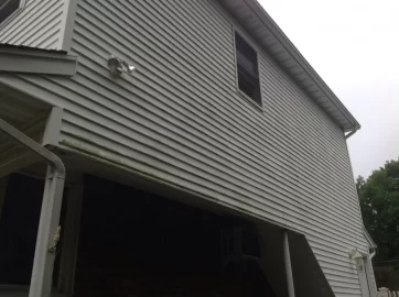

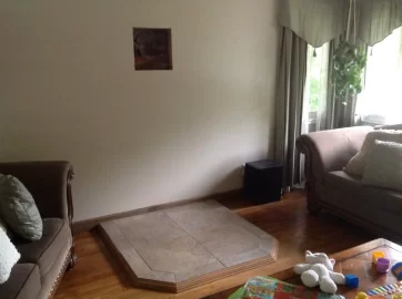

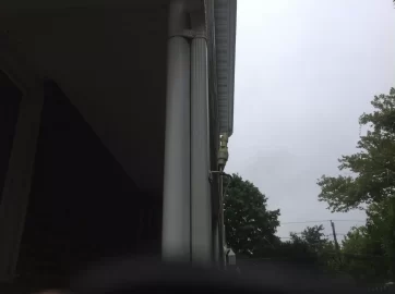

Thank you guys for the Welcoming. My real concern is draft and creosote buildup in the elbows and offsets. I am just worried about running the stove almost closed for long burns and getting bad buildup. My wood is split 18 months ago of oak,maple and mulberry. I feel if I run the stove open more hotter it will be too hot for my square footage. I don't want to clean the pipe out every month. I will be burning for my Primary heat for my home. I cannot run the pipe straight out due to a dormer above the room. If you see the picture it would be a 90° elbow going through the wall through the brick to the outside. Then it would go another 3 feet horizontal pipe to a T that goes up 14 feet vertically. Then 2 30° offsets around the gutter and than a additional 4 foot vertical going to cap. The pipe will be about 14 feet away from the roof peak. Do you guys think this set up might be difficult with drafts.
[Hearth.com] Help Please [Hearth.com] Help Please [Hearth.com] Help Please
This sounds like a bad plan. I don't like the horizontal run of class A at all. You want that thimble to be as short as possible. Go straight up through the room above and box around the pipe or figure out another location for the stove.
Really you think it's a bad idea but maybe it might work but if you think it's going to be a problem I can always ask the installer. I would hate to look at a boxed out pipe upstairs in the middle of the room. The chimney sweep installer said he will raise the horizontal pipe a quarter inch for every foot. So it probably will be about three quarters to an inch rise is that significant enough for the draft. He also stated that it might take a little Longer to get the pipe heated up. But once it's going it will be fine. He says. What about a outside air kit with that help me with the draft.
OK, I see what your concern is with the room above now. I think the odds of it working well (as proposed) are very slim. The horiz. run looks like it will be more like 4ft. This is really going to hurt draft. With an interior 90 elbow and a relatively short stack this sounds like a creosote factory. I am also not sure it would be code legal traversing an open porch. Supporting it would be a challenge and it would look like something out of the backwoods. Before deciding, be open minded and think about rearranging the layout of the stove room so that the stove can placed on an outside wall. That will get the pipe out of the middle of the room if you go straight up, or it will afford the option to have a short exterior thimble to a chimney that goes straight up.

BG has legit concern. 2 90's and a couple 30's or whatever you use for offsets is too many bends.
May work, but most likely your draft is going to be poor, and you will be cleaning it monthly or worse.
If it was me, I would be looking for somewhere else to put the stove that gave me a straight shot up and out.
Even if you did 2-45's inside and straight up to get near a corner or closet to be boxed out, would be better than all that going on outside and then going around the gutter.
That horizontal run outside could build up lots of creosote.
Without a strong draft, you may not be able to run the stove as low on air as you are planning.

True guys, I think I better see if I have other options I can do. I will have to plan out something that might be better than what I have. But moving the stove really is no option. It's in the middle floor of my split-level which is perfect to heat my whole house. And there's no other place in the room to put it.
Rearrange the room. We reversed our living room layout to do this. The stove will still heat well if it's not in the middle of the room. Our stove is in the northeast corner and does a great job of heating the house.
I tried other options and there's really no other options I can go with. Other Locations still need to be offset to go through the ceiling so the pipe could be boxed out against a wall or something. You guys really think this set up I have now wont work. That I will have big Creosote problems.
