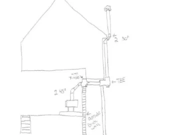

    Sounds like your course is set. Adding some extra pipe up top and bracing it may help. Try to pitch the horiz. run up 1/4" per ft. and watch clearances at all points, especially at the tee.

    Thank you, I talked to the chimmey installer and he said he will put an additional 4 foot height above the gutter and pitch the horizontal quarter inch per foot. Do you think the smaller stove my be better for my Application. Or do you think a catalytic stove would be better than my secondary air noncatalytic stove.

    This is not a matter of stove size. It is more a matter of how the stove breathes. Stoves are not all built the same. Some have long secondary preheat manifolds and others are shorter. Some cats have no secondary air feed at all. Draft is the engine that drives the stove. Dry wood is just the fuel.
    What will the total vertical rise be from stove top to stove cap?
  11. Treemoss
    Treemoss
    Member 2.
    Sep 1, 2013
    127
    22
    LI NY

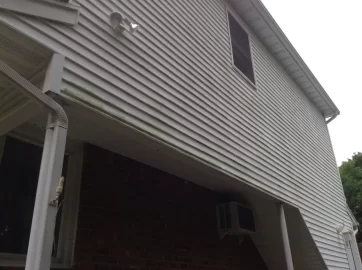

    There will be total of 20 vertical ft. Without the 4 ft horizontal and the offset passed the gutter.see pic.

    Treemoss,
    I would lose the 2 thirty's at the top, and cut a hole in the roof/sofit, and go straight thru/up. Two reasons, one is for better draft, straight pipe..., but more importantly, for strength. A support box going thru the roof will hold much better than the two 30's passing around the gutter.
    Ask me how I know this? Ok, since you ask, because I did the exact same thing you are about to do, but for my oil burner chimney. It lasted 3 weeks and the top blew over/bent/broke. They came back and re-did it thru the soffit and its 2 years later, and 2 hurricanes later (Irene, Sandy) and its still perfect.

    Next to nuke plant Berwick, PA.
    That is easy enough on a rake edge, but he is running at the eave. Can't just cut that out and the gutter etc. Ain't gonna work without being a PITA and looking quite awful.
